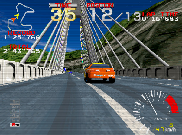

The higher-res textures is an interesting thought. I can't see it in the video (maybe I need to look harder), but as you probably know the game more than anyone, I'll have to take the idea seriously . It doesn't mean the game can't be hacked to get the textures a lot better (although easier said than done).
I really do think this is the case take this picture for example...
The decals on the car and the lights etc just don't look as defined what so ever. Perhaps its projector vs CRT or smaller CRT vs a massive 30 odd feet projector screen I'm not sure but if you look at the video you can see the car details, clouds etc seem so much more detailed.

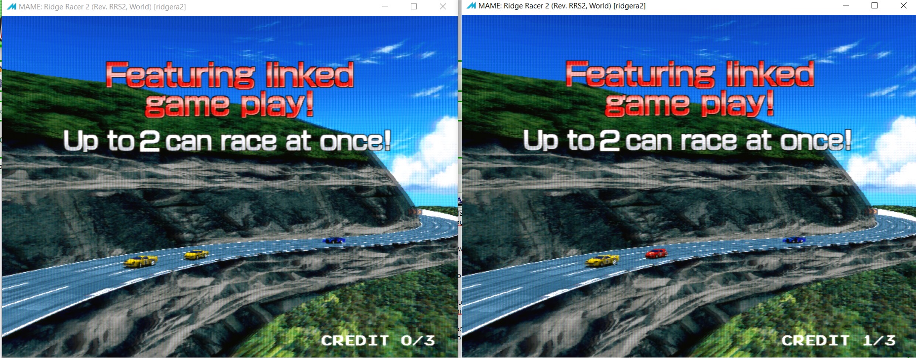

Ok, I've not done anything much on this in a while, but folk wanted to have a try of the multiplayer linkup WIP.
So, if you download this link, you should be able to have a go at:
Rave Racer
Ridge Racer2
https://philwip.com/wp-content/uploads/2021/09/Mamejb_1.zip
Install it then get the ROMs for those 2 games.
In the folder you will see some batch files
linkup1_to_2.bat
linkup2_to_1.bat
Run both of these to open 2 MAME instances and open the game twice.
It will run like sh*te (1fps) until both instances are open as there's a comms wait in there I need to improve somehow.
Anyway when both running, go into the service menu (Tab, dip switches) and set the CPU number to 2 in the second player and maybe pick a different car colour). Unset the dip to save it. MAME should have two sets of configuration folders - one for each instance. It might be a pain to do as the keyboard may input to both sides, but you should be able to muddle through.
It should now work with 2 players on one PC. Windows will ask for access rights for MAME - say yes. This is because it uses 'globalcomms' to link the games up, the same way the Sega stuff does.
If you read up on how to use that, you should be able to put one instance on another PC over a LAN. It'll involve editing the addresses in the bat files. I've never tried it.
If you want a play of fullscale, then so linkups1_to2, 2_to_3 and 3_to_1 (as it's 3 instances). I think I set the jumpers right for it to run. It's obviously a technicolour nightmare with bad video ROMs. Needs a beefy PC, but it's now spreading the load over multiple cores, unlike one instance of MAME, so I can run it at 60fps here https://www.youtube.com/watch?v=ztgspA9GuCg
3 or more players craps out on RR2 and Rave Racer - too many dropped packets in the chain. I need to think of a sync method, but it's hard when there is no 'master' PCB in the Namco system (all boards are considered equal).
Ignore any other 'supported' games in this mini-build - just things I've been dicking on with. You'll want to turn scanlines down too - not appropriate for VGA games and looks awful.

Hi John,
Thanks again for posting this.
I'm still working on getting this going 100%. Some notes below on the progress
PC#1 in Cab #1, hostname: ARCADE-RR-LEFT
MAME.ini config set to listen on port 15111 on all IPs, remote server ARCADE-RR-RIGHT on port 15111
PC#2 in Cab #2, hostname: ARCADE-RR-RIGHT
MAME.ini config set to listen on port 15111 on all IPs, remote server ARCADE-RR-LEFT on port 15111
turn off windows firewall on both PC's
ping ARCADE-RR-RIGHT from ARCADE-RR-LEFT and vice-versa to confirm connectivity.
run jbmame on left cab first. Mame will stutter until jbmame is launched on right cab (as you say above, 1FPS stuttering as it tries to net link to cab 2). With both MAMEs running they run smooth.
Left cab, tap F2, game settings, set to Car #1 Yellow
Right cab, tap F2, game settings, set to Car #2 Blue
(same as what needs to be done on the official cab.)
However at this point, the link says "link on 1" for both cabs for some reason. Compared to the official cab, cab#1 should automatically say "link on 2".
I started the game anyway on both cabs but no link working yet. I'll keep plugging away at this.

Have you set the CPU numbers or just the car colours?
It should say link on 2.
I've never tried it across a network, just on one PC, so might be worth checking you can get that bit working as well, via 2 windows of MAME.
It sounds like it is communicating if it stops stuttering when the second instance of mame is opened. I might have to remind myself of the debugs I put in the DOS window you get alongside MAME, as I used that to look for missing packets of data.
I'm not sure what you'll do about the resolution. The game is 640x480 via 480i interlace. What do folk normally do to drive 15kHz CRTs from MAME in interlace?

It works perfect John!
The problem was the network port. I assumed you were just using different ports (15111 and 15112) as you were on the same PC and needed to use a different port for each instance, but actually the port number is used to point to the next car number.
PC#1 Left side, Car 1, hostname: ARCADE-RR-LEFT
Uses port 15111 locally and points to the right side PC hostname ARCADE-RR-RIGHT on port 15112
mame.ini settings:
# CORE COMM OPTIONS
comm_localhost 0.0.0.0
comm_localport 15111
comm_remotehost ARCADE-RR-RIGHT
comm_remoteport 15112
comm_framesync 0
PC#2 Right side, Car 2, hostname: ARCADE-RR-RIGHT
Uses port 15112 locally and points to the left side PC hostname ARCADE-RR-LEFT on port 15111
mame.ini settings:
# CORE COMM OPTIONS
comm_localport 15112
comm_remotehost ARCADE-RR-LEFT
comm_remoteport 15111
comm_framesync 0
With this in place, Car 1 is set automatically to link on 2 and Car 2 is set automatically to link on 1.
Works perfect. Amazing work.
Thank you again John!!
