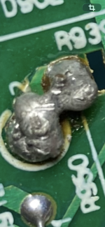

Ugly blob of solder is
Grey wire coming from underside of flyback
Looks like G2 ..
Is this ok ? Something they did in factory to help ?
Or needs attention ..

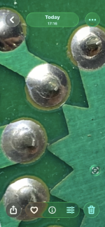

7,275CR
Touched up them rings ..
It’s ok now ..
