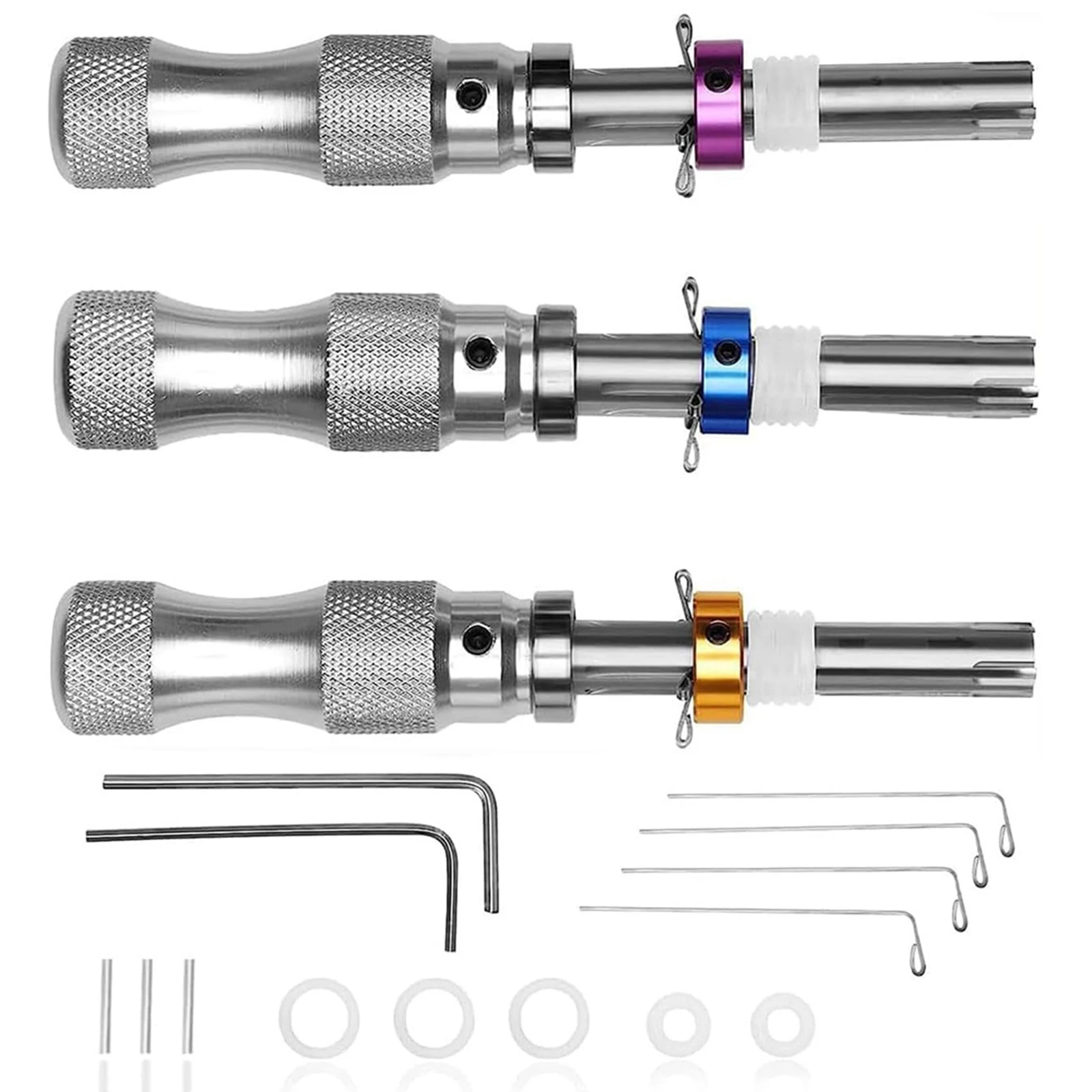

You can get pick lock tools from aliexpress for the round lock type for fairly cheap. You have to be carefull which ones you buy though as I got a set recently and they didnt have the tension pins to put inside the barrell so would just turn on the lock so sent them straight back and bought another set that showed the pins in the pictures.

worth taking not though that this is only a set for locks with 7 pins, your lock may be different

The lock pick shown bit like a pen barrel but metal with seven tensionable probe feelers align with pins pushing in to simulate the round key recess pattern then turn carefully but if there is tight pressure on the tongue it’s really hard to turn them and ideally you need to guess or remember if it turned clockwise or anti-clockwise before key was mislaid?
I have opened a huge number on round lock fruits secure turn handle locks on change machines and crane grabs etc, just technique and trial takes maybe 15 seconds - 2or 3 minutes save drilling as that doesn’t work if you can’t knock it through the lock body for any reason? Like if tongue is in a metal slot recess it won’t go backward.
Some glass / button panel locks on fruits don’t have enough space to insert pick above win tray . They need a different tool altogether!
