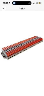

Plan B for if I cannot get my Iona jvs to usb to work with ttx2 multi .
I have orderd one of these
To tidy it all up
Any one know of a small 30 way quick disconnect ?
