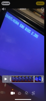

I have my exact bios
It’s pretty basic form other bios I see online etc ..
I am supposed to run 2 drivers
First to set the stage for pnp driver to then be installed.
I can only see options for
DMA 1 & 3 in my bios ?

It was mentioned a while ago that there was an issue with the CMOS backup battery.
If that's the case then your autoexec file should be fine and the settings in BIOS that govern the IRQ/DMA and addresses will have been lost.
