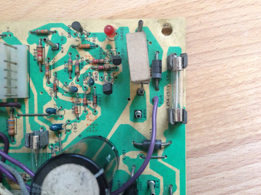

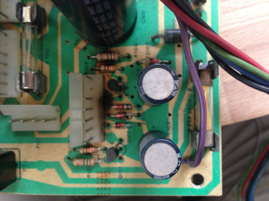

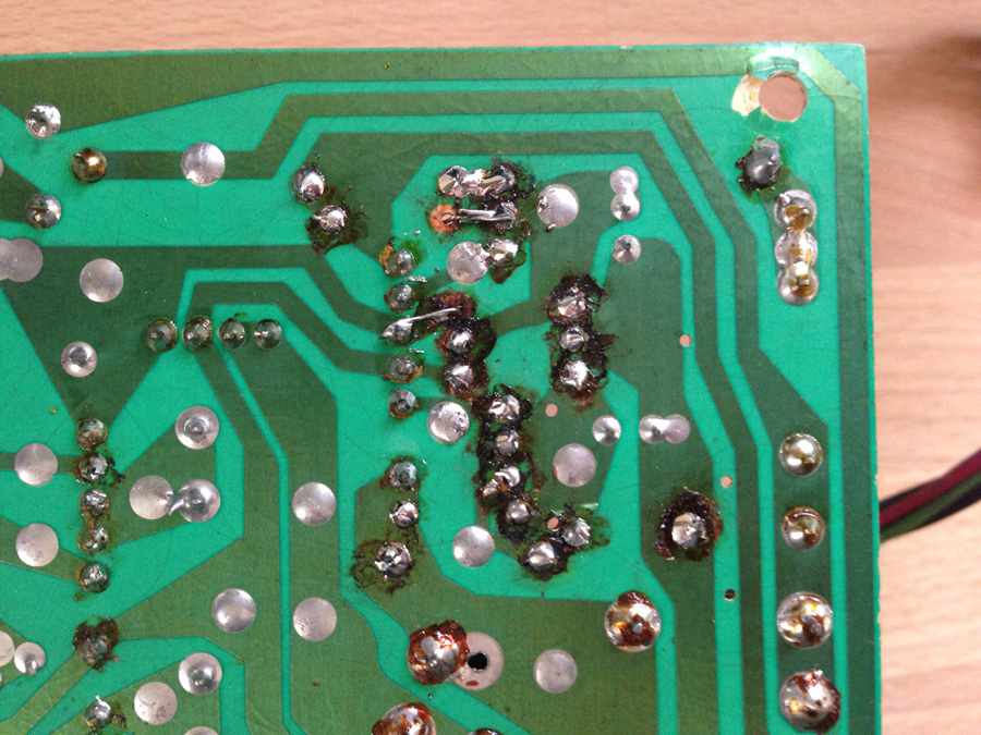

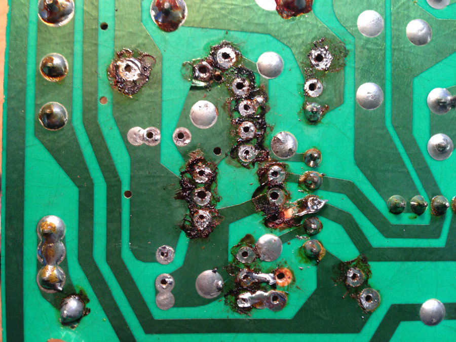

That soldering is rough maybe give you time to tidy that up? Is that a burn on the plug in pic4? nice project all the same be good to see that burst back to life
Ronnie
2,214CR
Yeah that looks like the burn from whatever caused it to be repaired before. I've checked continuity across the repairs and it's all good.

The burning around R100...normal, I would just replace the section with the LV2000 kit...just better than R100 burning a hole (which my deflection had). :-(

LV2000 installed now, get to bypass all that horrible burnt area.

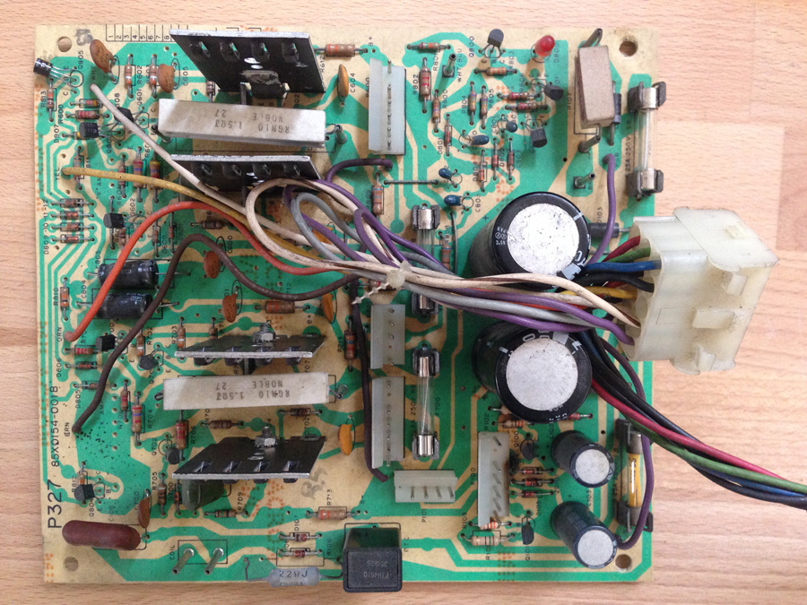

I notice this is one of the later deflection boards...P327, so it has had some upgrades the earlier P314 did not have as standard of course. Notice the 4 larger diodes in the rectification section, this is far better the tiny ones in the original design.
The HV cage should really have the 2x pico fuses adding to protect the other circuitry from failure.
-you can get these separately, no need for the 'kit' from the US, just get the parts off Ebay, RS, Farnell, etc. :)
