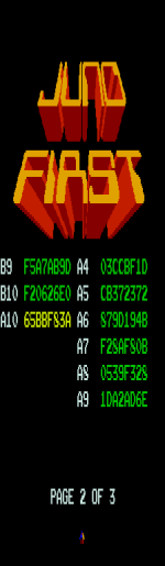

Green lines down the screen and text has jailbars across.
Looking at other repairs it looked like the 4116 ram so I ran @NivagSwerdna test rom but that showed all vram to be OK.
Next I thought it might be the 7489 ram but it wasn't that either. I swapped out the 083 and 083 customs from my hyper sports but that made no difference.

Just tried the test rom again and saw something I missed.
The green lines appear to change as the test goes on but not in a consistent manner and disappear during the sound test for a while.
Didn't notice this during the gameplay as there's a lot going on so the test rom has helped me spot this.
I don't now think it's a ram issue as the lines are broken in a very consistent way so it's possibly some timing signal being off.

The video is quite interesting...
Firstly the JUNO FIRST and the space ship along the bottom are painted by the blitter hardware... and that looks fine.
On Page 1...
STATIC OK has some bits missing and they seem to have been painted repetively elsewhere but in the wrong direction...
On Page 2...
As the checksums are rendered the more green lines occur...
When the 2nd column is painted... more green lines...
There are definitely bits missing from the checksums that then manifest themselves as green lines...
Again the blitter ship works fine until right at the end.. an extra green line... weird!
On Page 3...
You get a green line and then it disappears (as a side effect of the SFX numbering)
It comes back at SFX 08.... and interestingly the blitted ship causes a green line to appear and disappear!

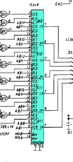

Let's not blame the Konami 081 for the moment.. the interleaved DRAM timing is a nightmare...
I would be tempted to socket and swap the 74LS153s around that mux the addresses...
