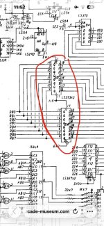

One of these 2 ls373’s
E15 ,E14 ?
I see DB6 goes to a couple of the 4116-2’s ?
C15 & D15…
I understand now the 4116’s are dual purpose very efficient !

Did you use ? Or is a schematic of this custom been drawn ? Was it required for this repair ?

I see data bus handles pixles , colours . But how do you narrow it to db6 ?

I couldn't tell from the oscilloscope if the 4116 ram was bad and I couldn't slice it due to the +12V and -5V the chip uses.
I used a video probe to see which data line had the same signals as the green lines appearing on the screen.
It turned out to be the D6 data line. I had sliced the 373 so knew that was good and I had swapped out the 083 custom with a known good one so the only possibility was the 4116 ram attached to the D6 line even though the ram test had shown all the 4116 good.
