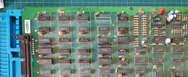

Bit of progress. Was checking the address bus connections from the main CPU that go through three ls367 hex buffer/driver chips. Found that the A8 pin on the CPU didn't have continuity to any of the ls367s. Traced back and found a tiny break in the trace that I could only see properly after removing the solder mask and viewing on my microscope.
I now seem to have both CPUs running solidly without any watchdog kicking in at all, but still just a screen full of garbage, but at least it's starting to look like graphics a bit, now. lol

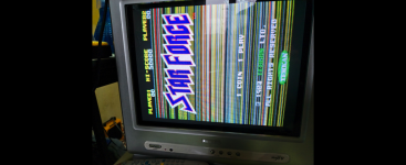

Almost there, I think. Phew, what an effort.
Things improved a lot, after finding this via between the cap was blocked with crud, and didn't have continuity with the via to the left of it (black dot). That connection carries the CPU read signal to a certain section of the top board.
I also discovered that replacing the faulty 6148 VRAM with 2114 wasn't a good idea. The 2114 isn't fast enough for the job. In my defence, I did replace it before I found out it was VRAM. There's quite a lot of 2114 on this board.
