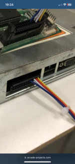

I don’t know why I wired my analogue connector the way I have
Because I can’t remeber where I got the info from when I made this about a year ago..
but looking at Mirko on arcade projects
He is wiring it like this
And he is using 7 wires ( I’m thinking extra blue wire is start button ?)
can anyone provide a pinout of the capcom analogue input.
I’m eager to rewire but
I don’t want to miss place the +5v.
I can’t find a pinout for capcom but lookiMy at Mirko pic it’s like for like with the sega analogue.

I wired with and with out amp pcb
Tonight and same fault
And I rewired the connector to io same as Mirko,
I have an issue with my stick I’m sure of it ..
I do have other analogue sticks so will
Try another stick tomo..
My issue is no forward & back wards
It did work once the first time I plugged amp pcb in and then after wards with our amp pcb it worked fine ..
Tried zombie revenge as well and same issue replicated in that game ..
? Did a pot just stop working ?

anyone know which analogue channels
Are correct for x & y on the banana
I understood its
A/D 0 ch
A/D 1 ch
But Mirko uses ch 0 & ch 4 ?
Any share which analogue channels they use ? Ta
13 (100%)
7,903CR
I think I have found it on planet harriers
Owner manual ..
😊😊. Jst RA 26 pin
pin 3 Y axis pin 9 X axis
Finally.
I have my x & y correct but not my AVcc …. My stick may be ok 😊🙏
