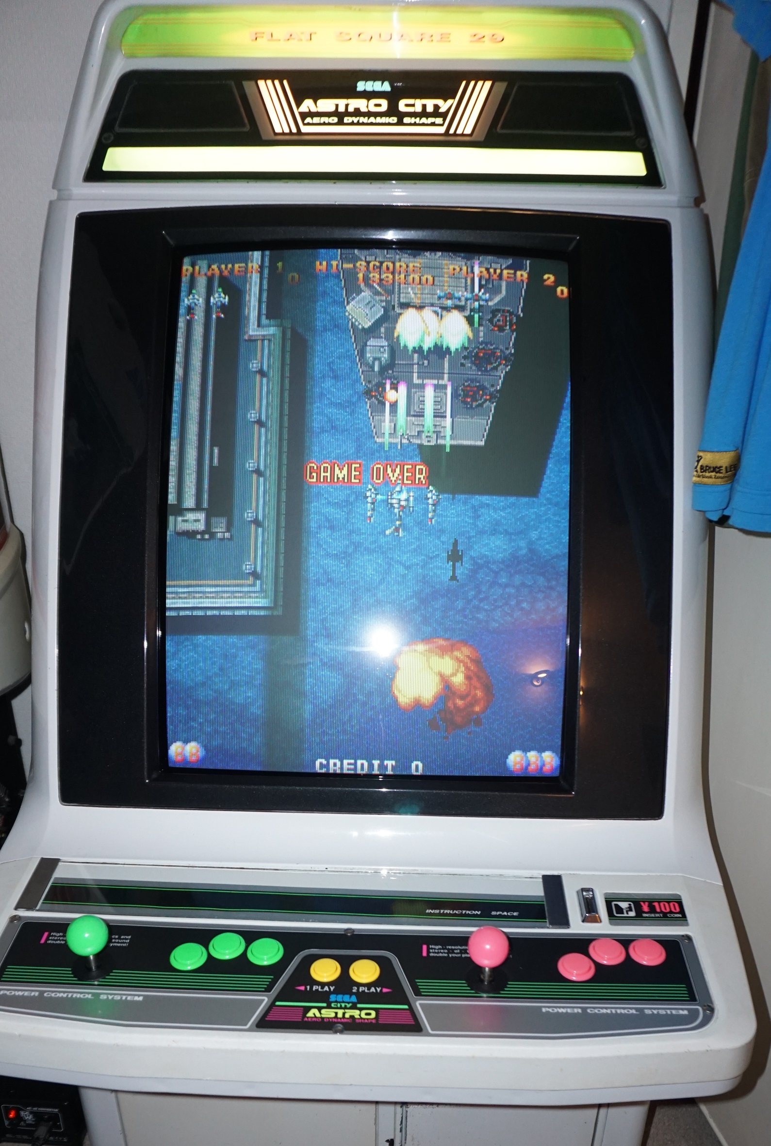

Thanks guys.
It took us a good few hours, but the monitor really came out great!
Hopefully it'll last another 25+ years. You are a legend mate.
Still going through my favourite games tweaking the colours a bit.
Almost there I think.
I love my Blast City, but, I think I like the look of the Astro City better.
It's very pleasing on the eye imo and goes well with the other machines in my collection.
