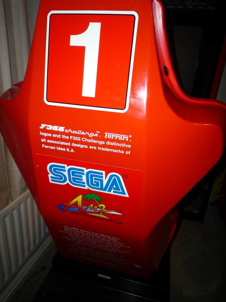

Fitted another seatback to the F355/2 cab, this time it has the elusive Am2 sticker.
I also managed to get another one with the sticker for the other side of my twin in exchange for my old seatback without the sticker, unfortunately that cab is currently in storage due to lack of space at the house.
I had to carefully peel the No1 sticker off the old seatback and restick it to the new seatback, there's a little peeling at the bottom LH corner but I can live with that. I never thought I'd get the Am2 sticker as it only appeared on Japanese F355/2 cabs.
I'm really chuffed to bits, that's ticked another box off the wants list.
A big thanks to Phil, thanks a lot mate!

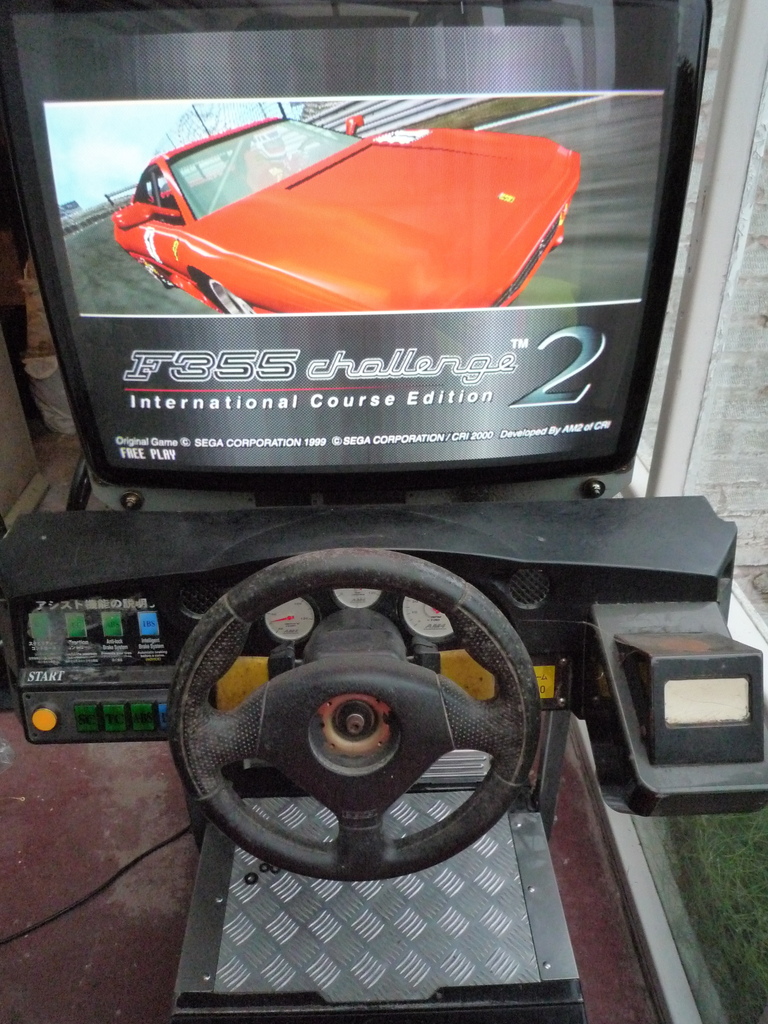

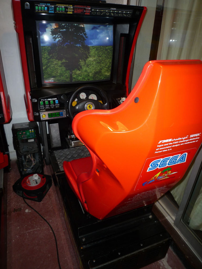

So today I transplanted the innards of the 2nd half of the UK F355 into a Japanese shell, basically upgrading it to a Jp spec F355/2 cab. I'm not gonna bore people with the gory details, but trust me when I say the cab was filthy!
So here's the money shot of the cab finally up and running, I love mouldy steering wheels!

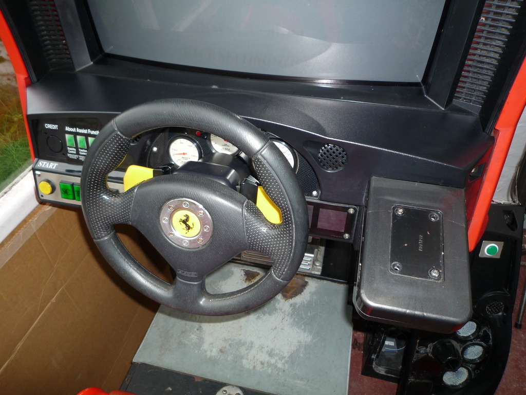

Just finished working on the cab for another couple of hours, it's pretty much there now.
Gave it a clean, all speakers are working, force feedback is good, dug out another dash from the hoarding pile and fitted it, fitted Jp spec F355 pedals, wired up the VMU reader. The monitor will need a cap kit as it's expanding and contracting on the sides when it goes bright to dark.
But that's pretty much it for now, I'm on a 7 day shift next week so won't have any time to tinker for a while.
Here's the cab showing an exciting tree.

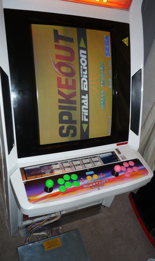

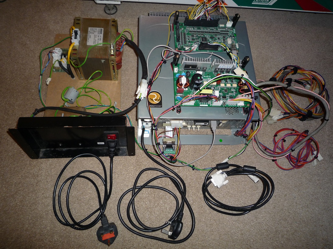

Model 3 loom installed into the Blast City.
The next thing to do is to sort out the looms + mixers from the DSB2/cage to the stereo connector on the loom. I'll also have to get some help to rotate the monitor back to horizontal mode.
I've been waiting such a long time to play SpikeOut FE as Sega intended, nearly there now!

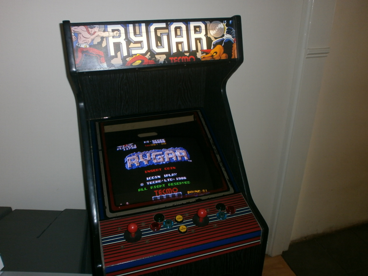

The picture looks nice on your Rygar cab.
You always love some Rygar action though! I'm not surprised as it's such a great game.

It's finally up and running but it aint pretty! I hacked the cabling to get 12v from the fan, but then found a spare 12v connector on the Model3 loom.
I need to tidy up the loom and secure it as the Jp cable tie thingies need sticking down, but that's for another day when I tackle a couple of other jobs on the cab.
There's something wacky going on with the sound when using a Sega mixer though, there no interference when I connect the Blast City Model3 loom directly to either the cage or DSB2. And when I wire it how I think it's supposed to be using the Sega mixer I only get 1 channel. I had to swap a couple of cables around to get it to mix both sound effect and music channels.
Well, I've spent enough time trying to work it out so I think I'm just gonna bite the bullet and get a powered mixer amp in the future. It'll allow me to set the volume on each channel and I can also use headphones.
I also managed to rotate the monitor by myself, man that was hairy!
I really don't want to be doing that too often.
The game is rock hard though, I need to stock up on coins.

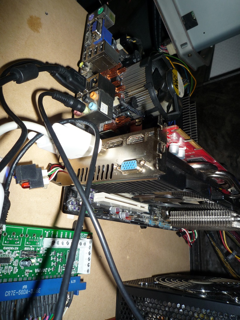

I've spent a good few hours over the past couple of days tinkering with a Ghettomame PC made from old bits. I encountered a few niggly issues with the JammaPI it spurred me on to sort this out rather than faultfind a system that I've no idea how it's setup!
I came so close to chucking the lot into the bin as the PC wasn't playing ball and the motherboard is on it's last legs anyway, it loses the bios settings when the power is unplugged but otherwise works fine.
Anyhoo, I had a major issue getting the HD4850 to sync on bootup with the MS2930 @ 15khz, I tried W7 and XP tna. I could get it to sync if I booted with my AOC monitor @ 640 x 480i then swapped to the MS2930, but it just wouldn't sync when powering on.
It ended up being that I needed to use the bottom DVI socket closest to the motherboard and then it worked fine. I stayed with XP in the finish as it loads quicker into windows and doesn't need so much ram. I overclocked some old high end DDR2 Corsair PC8888C4 ram which then gave a system latency of 59.7ms which is decent for such an old system, I also set the USB polling rate from 150mhz to 1000mhz.
There may be other speed tweaks but I'm happy with the result, it will do until I get the bits for a newer build. I also sorted out the cable management cable ties throughout the cab, I restuck them down with some strong 3M double sided tape.
I was debating about putting up some pics as I still need to sort out a bracket for the GPU and tidy up the cabling a bit better, but getting to this point was such a relief I thought I'd share them anyway. This PC has been through a lot over the years, it's amazing that it's still working!

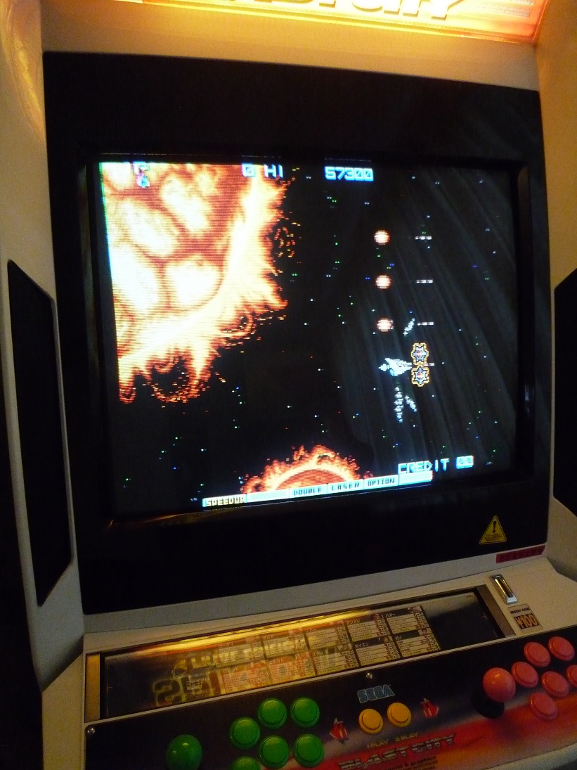

The Blast City is so versatile though, it can play almost anything with the correct loom.
Just need to sort the monitor convergence now, but finally I can play a lovely game of Gradius II as nature intended.

I've mounted a mobo directly into my cab what did was to get an old pc case and drill out the rivets holding the pcb plate and backplane and then mounted that into the cab.

AnDyC said:
Don't leave that gfx card sagging!!
Nice one mate, cheers for the pic.
Yeah, gonna get some wood or something to hold it up in the short term.
It's actually resting on a Thermaright Southbridge cooler, but I know it's not ideal!
Just happy I got the thing up and running is all, you would not believe how much cursing I did working on setting up Groovymame.
