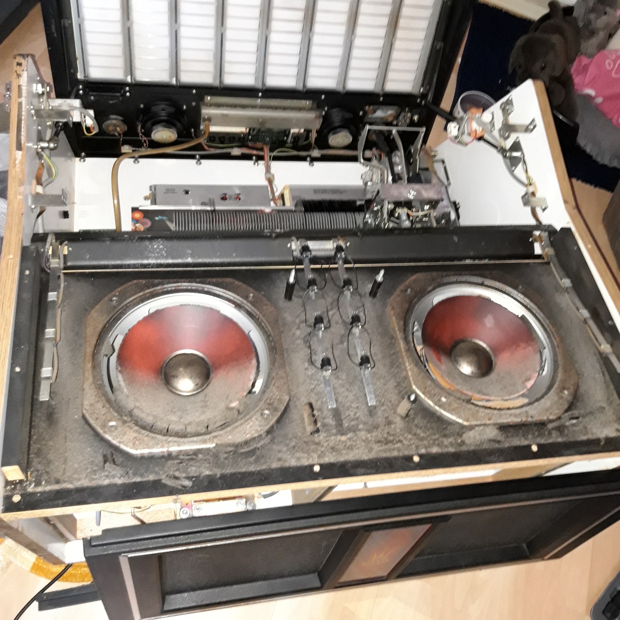

Not the best of jobs. Rotten speaker foams on my nsm city 2 jukebox.
LawmanAUT
78CR
@Chopper79
You can rebuild these brittle rubberrings from the speakers, I have done this with my old subwoofer. Replacement ( including glue ) was about 25€

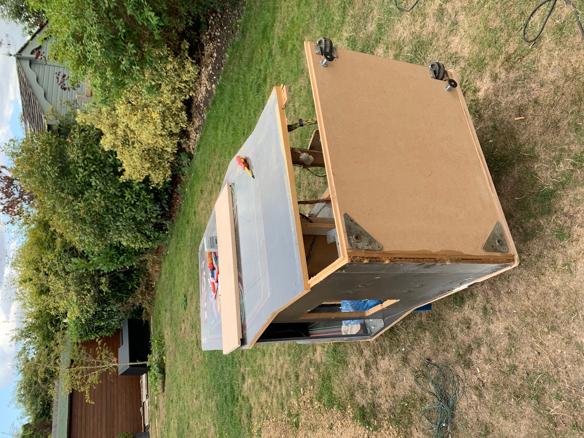

I am mid restore on this, trying to get painted and side art on
before things turn chilly, I think Spongebob Square Pants played it
judging by the water damage and swelling!
Will do a full restore thread when its done.

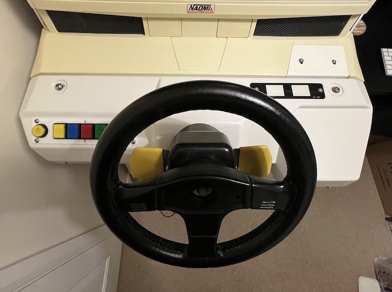

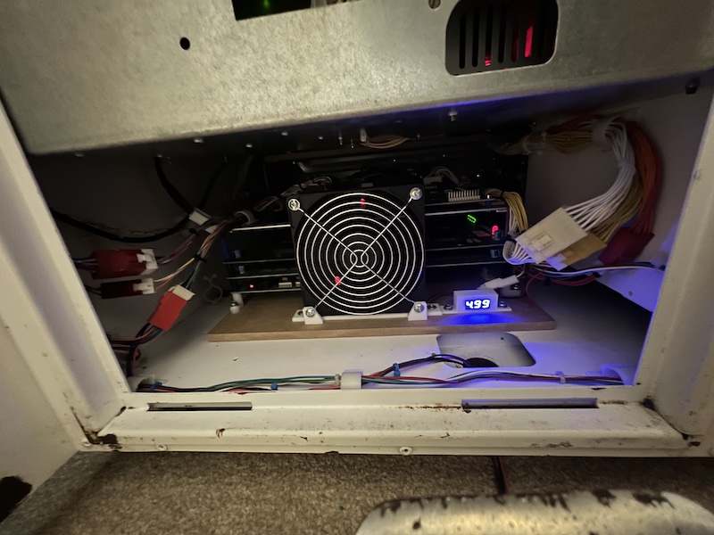

I picked up neoretro's very generous Naomi driver cab shell giveaway earlier on this year and I've been slowly converting it into a universal Sega Model 1/2/3 machine. I've converted a Virtua Fighter cab into a universal joystick based machine before for Model 1/2/3 stick based games but this will give me something to play my driving games in.
It's going to be themed around Virtua Racing. I'll make a short pedal section eventually but for now they're screwed to some spare plywood but I was happy to just get it all together and working.
So far it's involved: -
- Making the VR board set fit into a small enough foot print
- Modify the dash to fit an original VR wheel / mech / flappy paddle shifter
- Fit an MS9 expertly fixed by Grant
- A complete new wiring loom with original Naomi PSU and amp
- Dash modified to fit a Daytona button panel on a custom front plate. The plate will be CNC cut eventually but this one is 3D printed
The good: -
- I can play Virtua Racing!
- All connections are accessible just inside the front of the machine so I can wire in other game boards to play other games. I plan to sit the other game board on the base section's flat shelf at the rear of the machine and create an extension loom to wire it up.
The bad: -
- No sound yet for VR as I've not got he right eporms on the Model 1 sound board
- No force feed back. There's no room in the dash
Work of art or Frankenstein's Monster? The way I see it, My Sega Model driving games can now be played rather than gathering dust till I one day, (maybe never), find a cab to put them in.
Also, a Naomi comes apart so this cab is upstairs in my study rather than in my very full games room. The first machine I've managed to get in the house! And it was my wife's idea!

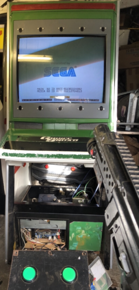

I am getting 2 naomi gun projects to near finished
Naomi cab ghost squad which is now all working
Also another naomi that I have not finished
But it has everything in place just not Very well!

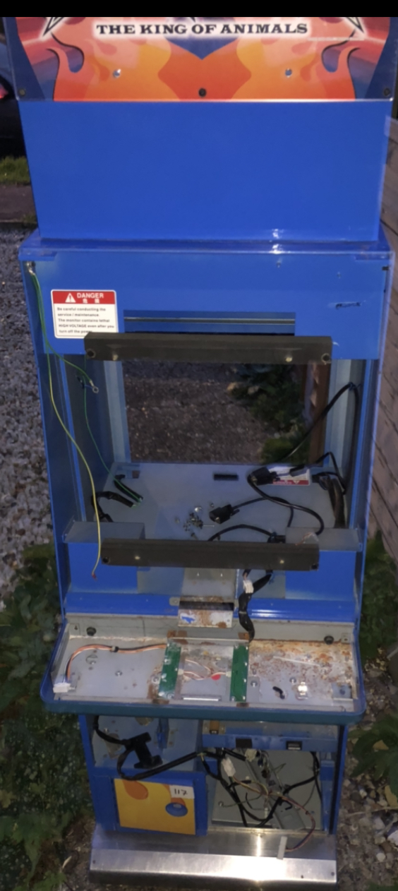

Also I picked up a animal Kiser which I have been working on the control panel
Striped kieser right out.
I’m going to pop a crt in .
Lcd it came with makes a good bench monitor..
Ghost squad fully working
After sorting broken cables
needs cosmetic work.
And some wheels on the stand.

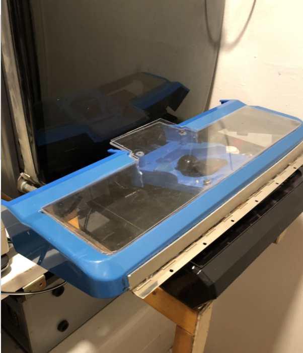

Control panel was totally unusable for stick & buttons
So had to just cut it all away.
Using clear Perspex for the panel 5mm
With a 1 mm top layer like the candy marquees so I can pop some ARTs underneath.
Got piano hinge mounted on stainless steel L shape
Will do same on Controll panel under. With Tiny m3 bolts slotted probably.
I can get 2player 2 button. Config on the panel but would love to squeeze
2 player 4 button for neo geo.
Also going to hinge the monitor bezel so I can tate monitor that’s the plan.
