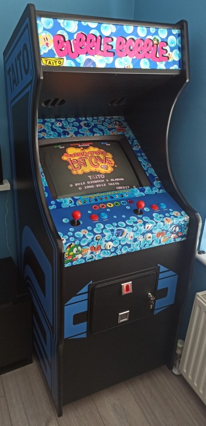

I've been working on getting an original Bubble Bobble board running both Bubble Bobble and Lost Cave (selectable with a switch). It's given me way more headaches than it should have done and what I thought would take a couple of hours has taken about 15! The process is a bit more complicated on an original than it is on a bootleg as you have to split one of the 64KB ROMs into 32KB chunks and then there's the part where you think you've done everything right but nothing works and you can't figure out why.
