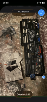

I have my sega io
Now connected to the new universal ffb pcb from aganyte gameoover .fr
And built a pc to run the games
I just need to confirm I have these connecters correct way round then try first power on to configure pc to the steering .
F355 Extention takes the analogue connectors for steering and peddles
