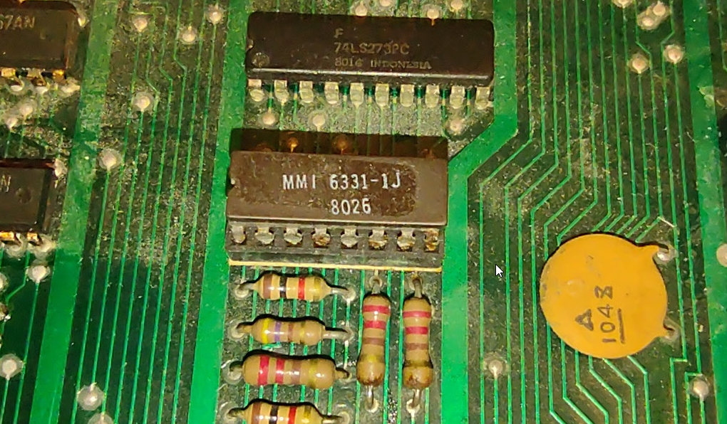

Whilst pondering graphics I thought it worth dumping the colour palette PROM at 6L. This is a 82LS123 or equivalent... in this case a very crusty MMI6331.
Removed from the socket and to be honest the condition is pretty terrible. Spent ages trying to clean the legs with a fibreglass pencil and contact cleaner but still am getting slightly indeterminate results in the Retro Logic Chip Electron Wrangler.
Eventually managed to get...
0000 : 00 33 c3 f6 00 17 c0 3f 00 d8 07 3f 00 c0 c4 07 00 c0 b0 1f 00 1e 71 07 00 f6 07 f0 00 76 07 c6
SHA1 Hash: d4ec6a54f72640e5b485aa59e206c090e67ff640
With your tongue at the right angle this is repeatable so probably what is in the PROM...

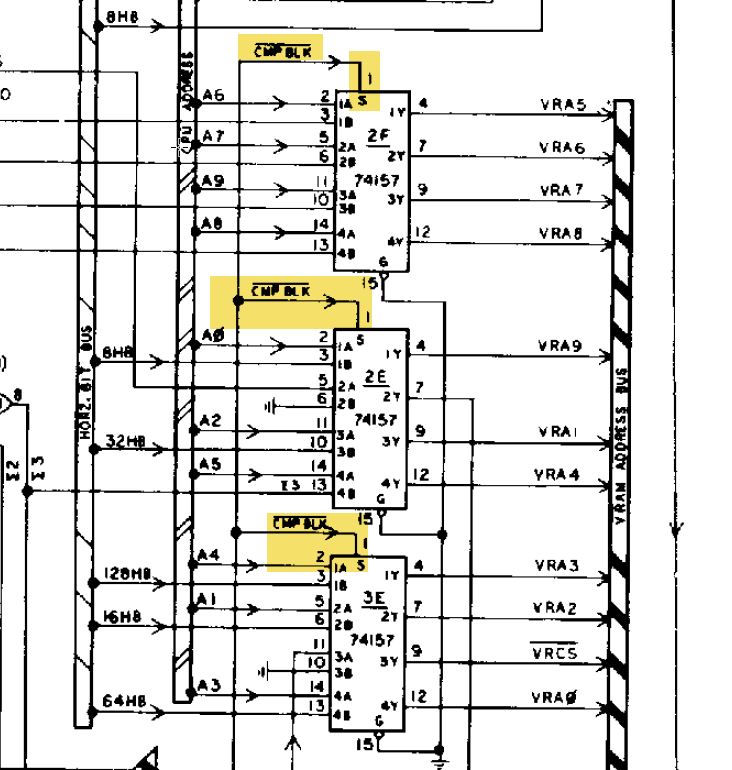

The choice of CPU or Video Address bus is done by applying nCMPBLK to the muxes at 2F/2E/3E.
Now the memory operations may be failing due to a problem on the data, address or control side but I'm going down the address route first. (I did probe the data muxes and they seem lively so will come back to them)...
Now the choice of CPU or video is done using nCMPBLK and this is derived from the video counters...

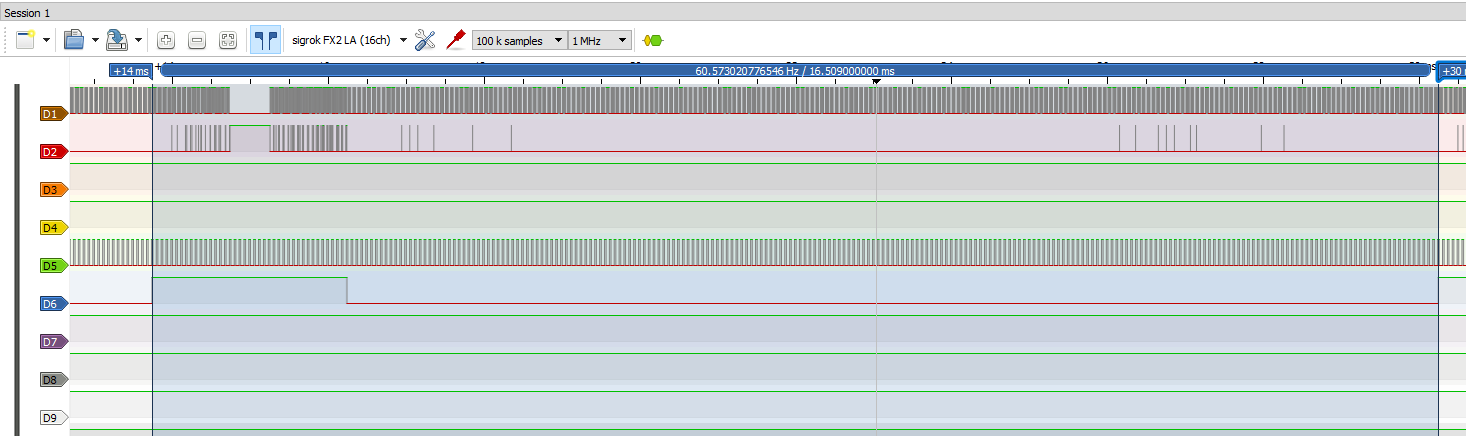

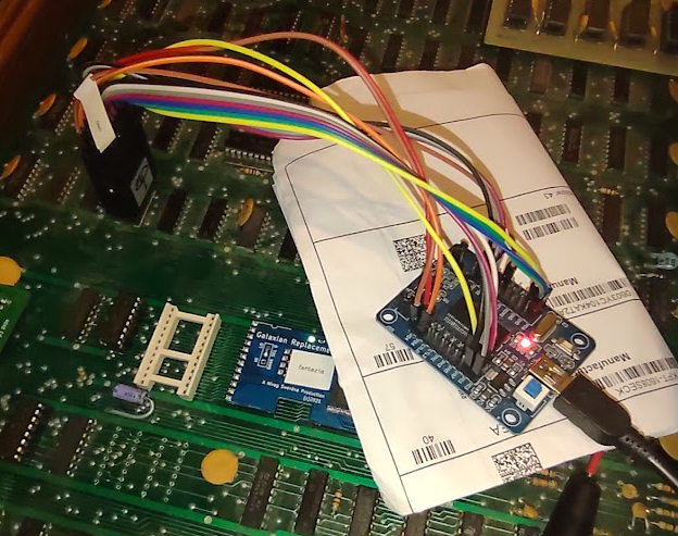

Pulled out the big guns... My cheapo 16CH logic analyser... (ebay USB 2.0 CY7C68013A less than a tenner)
(IMHO The trick with logic analysers is to use a chip clip e.g. https://warwickts.com/599/900738-16-Pin-Duck-Bill-06-Gold-IC-Test-Clip they aren't cheap but the alternative is having all your wires fall off which is very bad for your mental health).

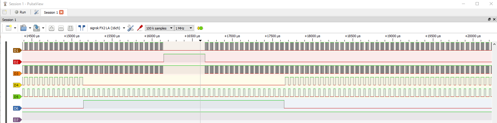

So looking at the 74LS74 first...
This is 5C... pin 5 is nVBLANK and it nicely has a period of around 60Hz, pin 6 is the inverse i.e. VBLANK so pin 6 should feed 6D nicely...
Now moving to 6D...
We see VBLANK feeding into pin6 and pin5 looks like it could be HBLANK (at 15kHz) but pin4 is stuck high. Damm should have been able to spot that with the logic probe...
So..

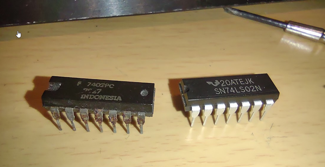

replaced crusty 7402 with a nice shiny 74LS02 at 6C..
Now p4 looks like a nice nCMPBLK... i.e. active low composite blanking...
And guess what...

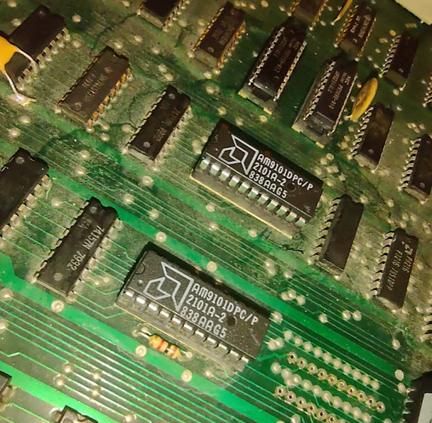

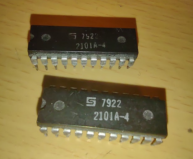

Memory problems with object RAM...
Removed 2101-2 at 4F and 5F and tested them and they appear DEAD
Replaced with two 2101 devices I have lying around which although I previously marked as bad seem to test OK now.
Throw out these bad boys...
and in with the 'almost' new...
And now the memory checks are passing...

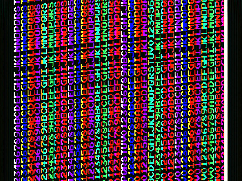

OK... so the video doesn't look great...

Now for the long haul to work out why the rendering isn't working... characters and colours first...
Not obvious
BTW... I tried to test the D2125As... but they seem all broken which is a bit unlikely so maybe I cannot test properly...

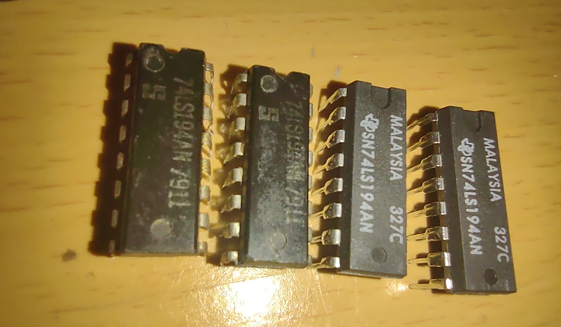

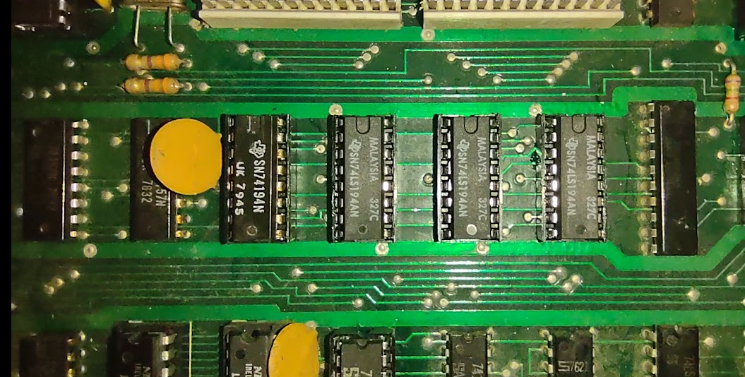

Macro
1,995CR

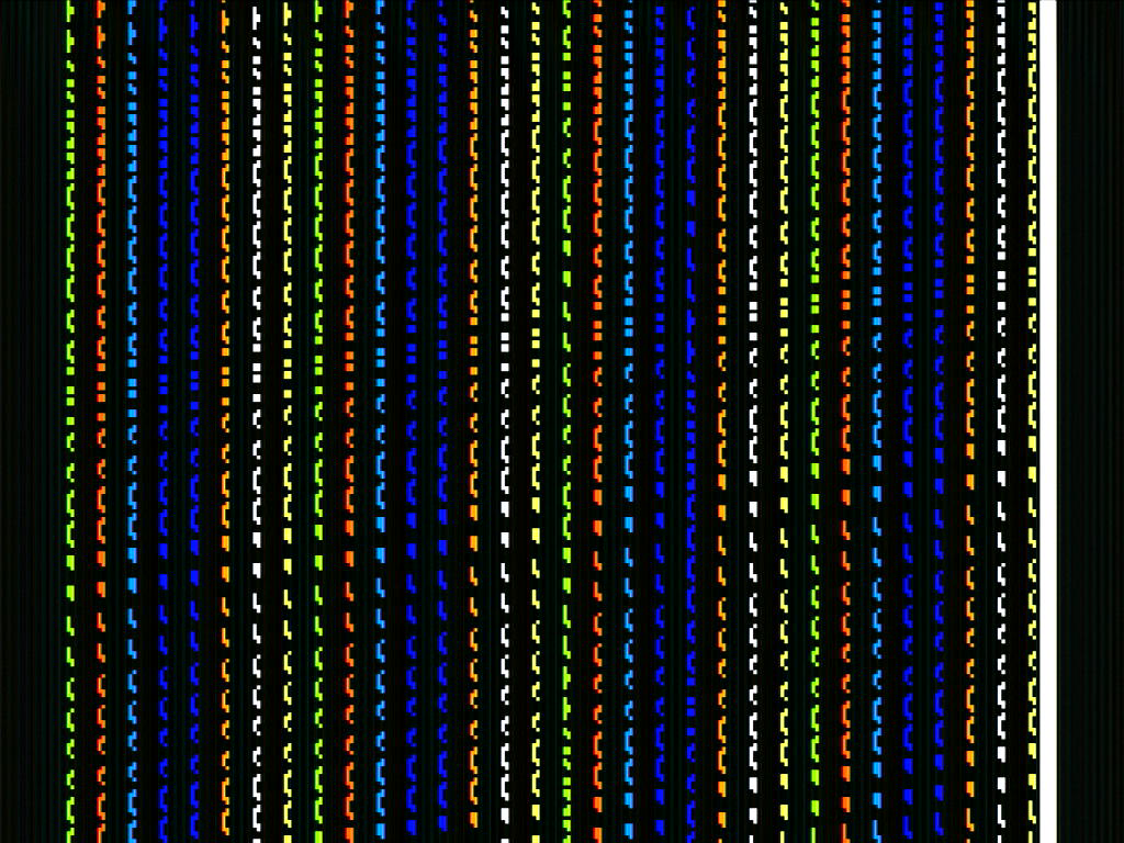

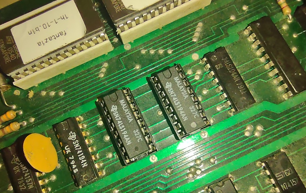

Looks like it's only drawing the first 4 pixels of each character - fitst screenshot looks like it says moon cresta afootm in the middle of the screen - or something like that anyway!
I'd check the 194's (2H to 2L) I think that do the parallel to serial conversion, seems like later bits are being lost, and maybe the 157 at 3L

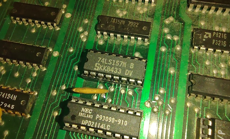

I note that outputs of 3J seem to be low but that would probably be more of a character selection problem. I will replace that first and then follow your lead.... that will have to wait until I have some spare time... maybe tomorrow night...
NivagSwerdna
836CR
Replaced the 74LS157 at 3J. The one removed does test bad so that was a correct call.
As anticipated this does improve the selection of characters... the test screen that has mostly blanks and then some text now looks... mostly blank... that's a good thing!

OK that's 3J and 3K replaced...
and we get a nice improvement to the rendering of the test screen...
The colours are wrong... I think the top two pixels are wrong which suggests that possibly 2L or is it 2H needs replacing as well...
Another test screen shows this is a consistent issue...
Might have to think about that for a bit before jumping in.
NivagSwerdna
836CR
So it was a gamble... either 2H or 2L... I should have thought about it more because it was obvious really but I gambled on 2H and lost... removed the chip and it works fine... removed 2L and it is duff. So all four 74LS194s have pretty new DIP sockets, 3 have been replaced by new and I put 2H back because I think it deserved another go. 75% of the shift registers knackered in the video generation part... I think this was probably a bit of a duff eBay purchase but I'm in it for the long haul.
But now looking pretty...
And characters now rendering better...

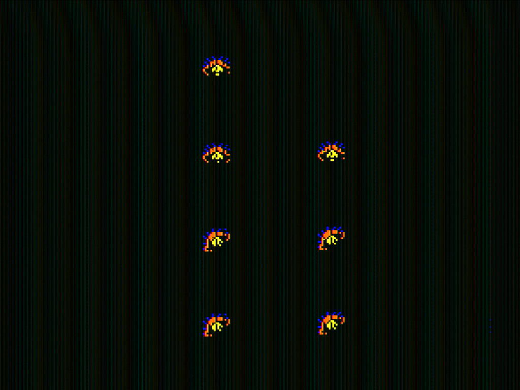

Sprites next...
Not bad... but show a degree of instability (sparkles) so something slightly off... Making good progress now though! There are some chunks missing too and definite stripy lines.
