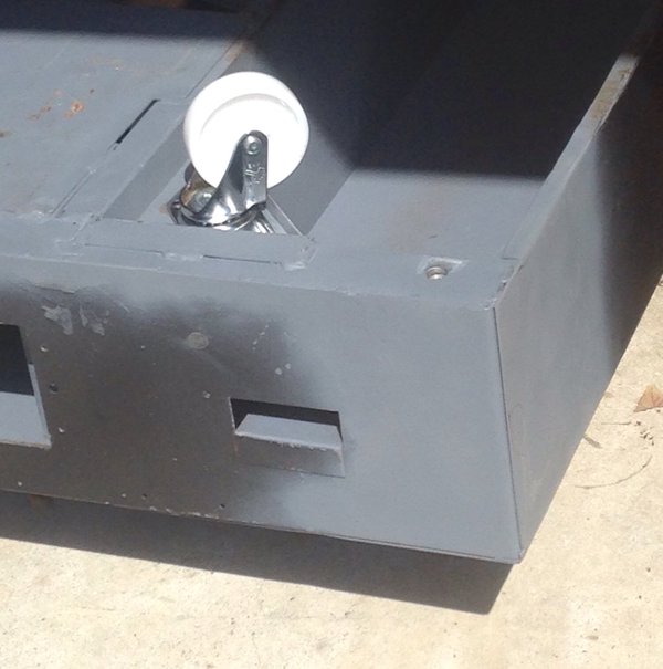

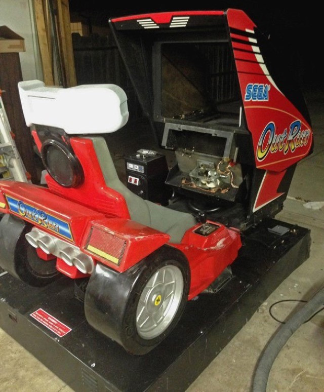

Finally got around to spraying my OutRun DLX base with the proper color matched finish (looks a bit lighter in the pic due to direct sunlight).
Wanted to get it done before the weather turns so I can start reassembly. The fiberglass pieces will probably have to wait for now
To give you an idea of what it looked like before, it had been previously painted over twice with the wrong colors:

panpar227 said:
Looking a lot better! How did you tackle that damaged corner?
Vamino said:
Well done stripping that down!
As panpar227 mentions, how did you repair the metalwork?
Cheers.

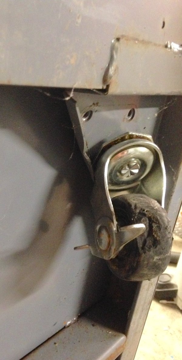

Thanks! A friend of my father-in-law's does metal work on cars and rebuilt the corner for me (part of it had to be cut out and replaced), and straightened the iron cross piece:
I straightened out the metal underneath the replaced casters and replaced them with OEM. The ones they were originally replaced with only had the single bolt mount - ~ 800lbs on those small points and no leg levelers mangled the metal pretty badly

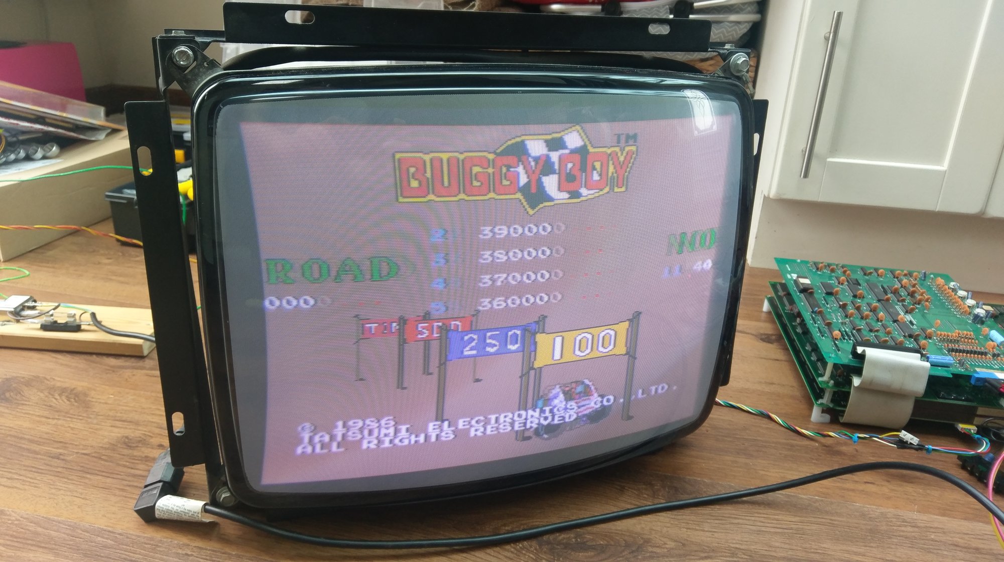

Technically this has been done on the kitchen table/floor but I changed this...
...in to this...
...as it would've bugged the t!ts off me. There's very little information about Buggy Boy online - had a look at it in MAME and the change is just a case of snipping a jumper wire on the sound board.
