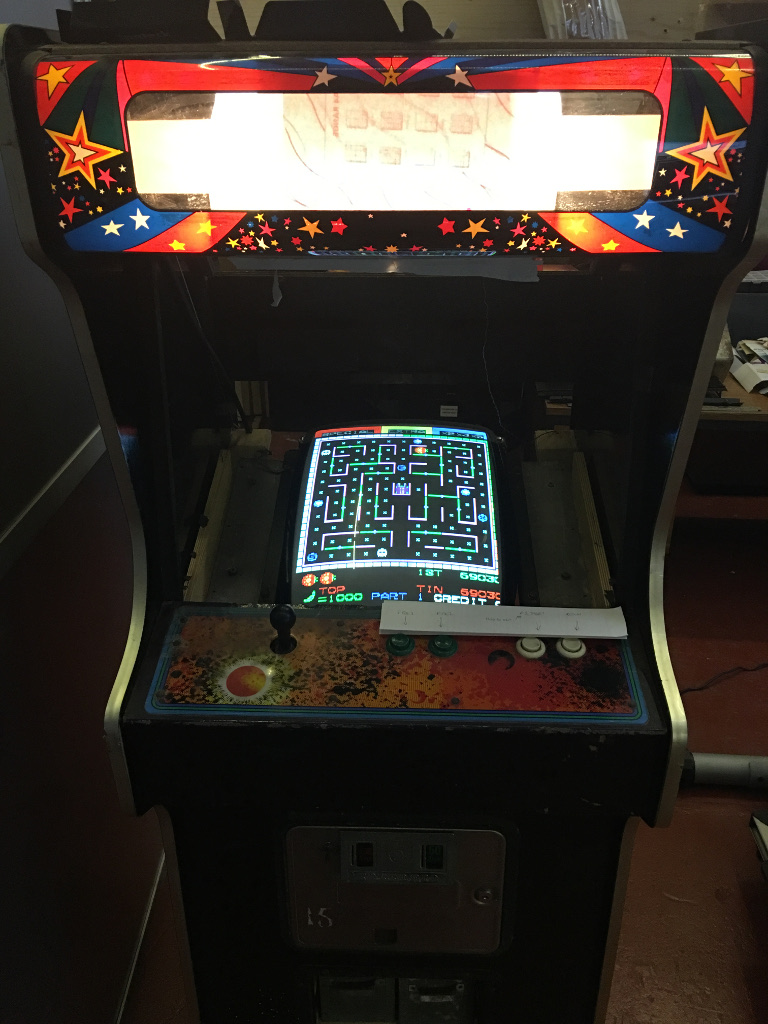

tin
655CR
Today on my extraordinarily slow Zac resto I fitted a LED marquee light and sorted (enough for now) the red on the monitor, and bolted it in good and proper. And had a go of lady bug
Just need some kind of marquee now to go in the window.
